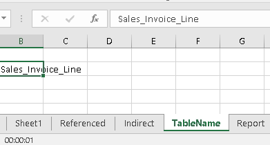

My method begins with creating a separate worksheet containing the table name created by Jet. In this case "Sales_Invoice_Line"

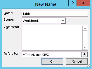

The first thing I do in this case is to define a name for "TableName!$B$2" to avoid typing this over and over. This can be found in Formulas > Defined Names > Define Name.

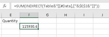

As a basic example, we can use a SUM formula with an indirect column reference. In this case, I have typed the column name into cell E2 and am using the formula =SUM(INDIRECT(Table&"[[#Data,["&$E$2&"]]'))
(Note that "Table" was defined in the previous step)
It can be noted that using an indirect reference to the table name and column name as shown results in no change to the formula upon pressing "Report" or "Refresh" in the Jet menu. That is, a formula like this doesn't get converted to "#REF!"

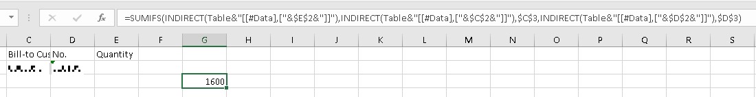

Formulas such as SUMIFS can also be used for applying multiple criteria to referenced table columns.
An example of SUMIFS is as follows
C2, D2, and E2 contain column names. C3 and D3 contain filter values.
The formula
=SUMIFS(INDIRECT(Table&"[[#Data],["&$E$2&"]]"),INDIRECT(Table&"[[#Data],["&$C$2&"]]"),$C$3,INDIRECT(Table&"[[#Data],["&$D$2&"]]"),$D$3)
sums the quantity column for entries in column "Bill-to Customer No." that match C3 and in "No." that match D3.

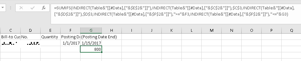

This formula can be further extended to limit by date. For example, using "Posting Date" as a column name in F2, a start date in F3, and an end date in G3, we can use
=SUMIFS(INDIRECT(Table&"[[#Data],["&$E$2&"]]"),INDIRECT(Table&"[[#Data],["&$C$2&"]]"),$C$3,INDIRECT(Table&"[[#Data],["&$D$2&"]]"),$D$3,INDIRECT(Table&"[[#Data],["&$F$2&"]]"),">="&F3,INDIRECT(Table&"[[#Data],["&$F$2&"]]"),"<="&G3)
to sum only matching values between the dates in F3 and G3.
