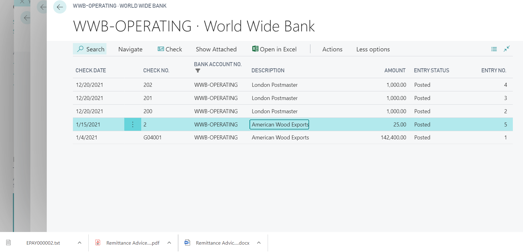

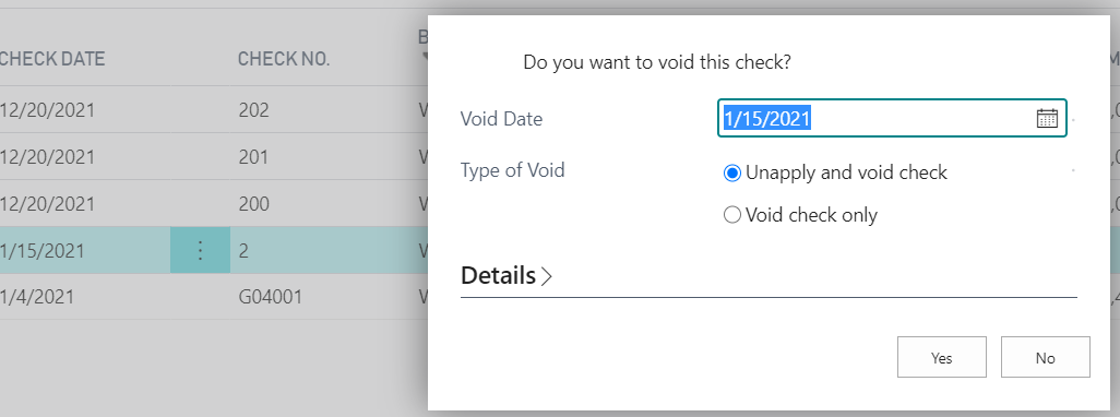

    Let me reply to question 1. In the Check Ledger Entries, for the ACH you generated, are you saying you cannot highlight the row and click Check/Void? Here is my images:
    On your second question, I have never seen this before but I will check around and if I find anything will reply back.

    When I click on void check for a check that has been cleared, I get the following message.

    Have you cleared this payment on a recent Bank Reconciliation? The message is telling me that you have as the Statement Status = Closed. If this is the case, you are left with manually recording the reversal of the Bank voiding of the check and manually reinstating the Payable. You can do this on a General Journal Entry, Bank Account on left as Debit and balancing Account can be Vendor.
