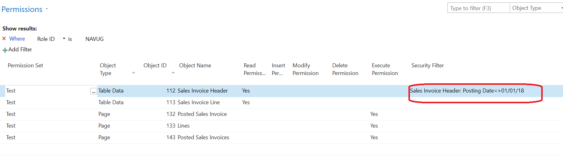

    A little tricky, but you may be able to create a permission set with a securty filter (Posting Date > mm/dd/yy).  I don't think you can use any date coding there so that people can always see for example invoices from the last three months.  You can put a specific date in filter so for example, the users cannot see invoices older than a specified date.
    I tested the setup below and it worked.

    Thanks for reply, security filter is working and one month old invoices are not visible but creating new invoice is failing with below error. Any advise?
