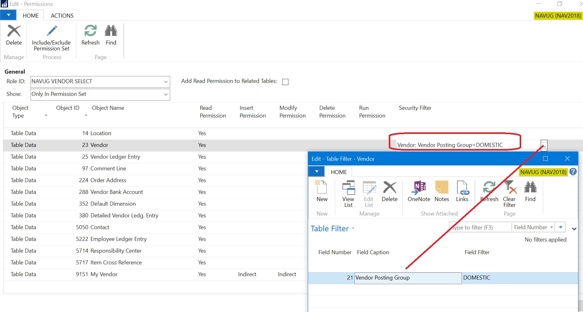

    Mergetool has a great add-on solution called EasySecurity that provides the ability to do field and data level security.
    Out of the box, you can create a new permission set and apply a field level security filter.
    For example, you can take the P&P-VENDOR or P&P-VENDOR-EDIT permission set and make a copy to create a new permission set.  On the new permission set, apply a security filter (see image below).  Anyone with the permision set below can only see vendors that have a Vendor Posting Group of Domestic.  You can pick any field on the vendor card to filter with.
    You'll want to test carefully to make sure that the user does not have another permission set that overrides the restriction below by allowing access to the Vendor table.
    Permission Set Security Filter
