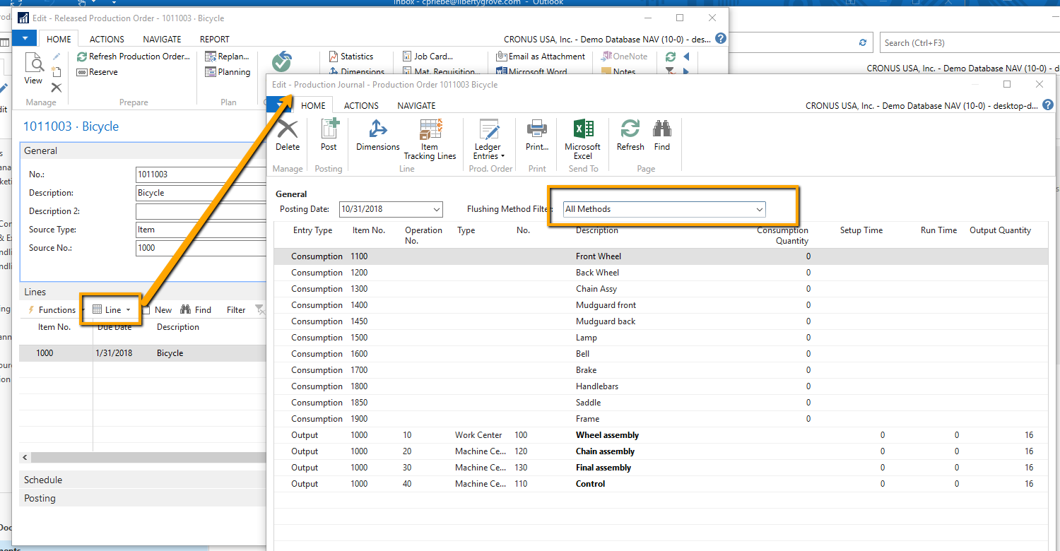

    Try changing the Flushing Method Filter on the Production Journal to "All Methods." Do you see the lines now? I can seeion your screen shot this is set to Manual (which makes sense) but curious to see if removed, the consumption rows become visible.

    I changed to "All Methods" and still only showed Output entry types no consumption. If I go to the Consumption Journal and call the order and calculate the BOM show up.
