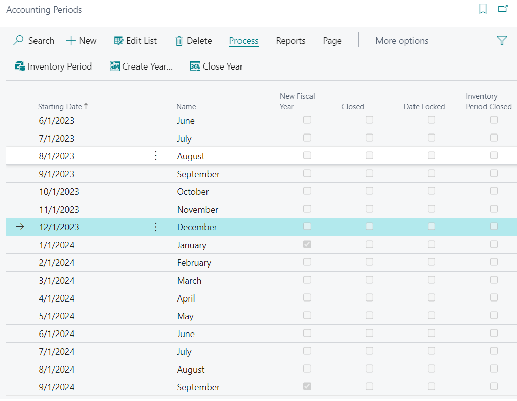

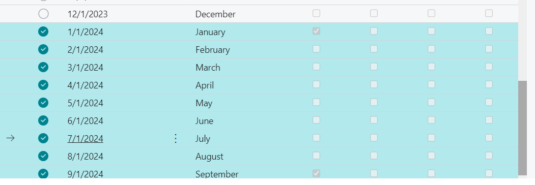

    To answer your questions the Close Income Statement uses the Accounting Period New Year flag to determine the Year its closing so this is not possible in its current state. However, here is my suggestion:
    1. First I would setup the Short-Year for Accounting. Open Accounting Periods and highlight the this Calendar year including January (see image). Then DELETE these records. This will remove the current Accounting Period year. Now Create New Year being a short-year thru 8/31/21.
    2. Now you have an Accounting Period to match the new Fiscal Year and can Close Income Statement. You can then create the NEW Fiscal Year either another short period 9/1/21 - 12/31/21 or different Fiscal Year all together.
    3. As for booking the Purchase Accounting Entries as of 9/1/21, I would post them on 9/1/21 the adjustment with a specific Document No. and reference (Ext. Doc. No.).
    You now have your 8/31/21 numbers and then a new Fiscal Year with the Purchase Accounting Entries hitting the Balance Sheet and then new operation postings.
