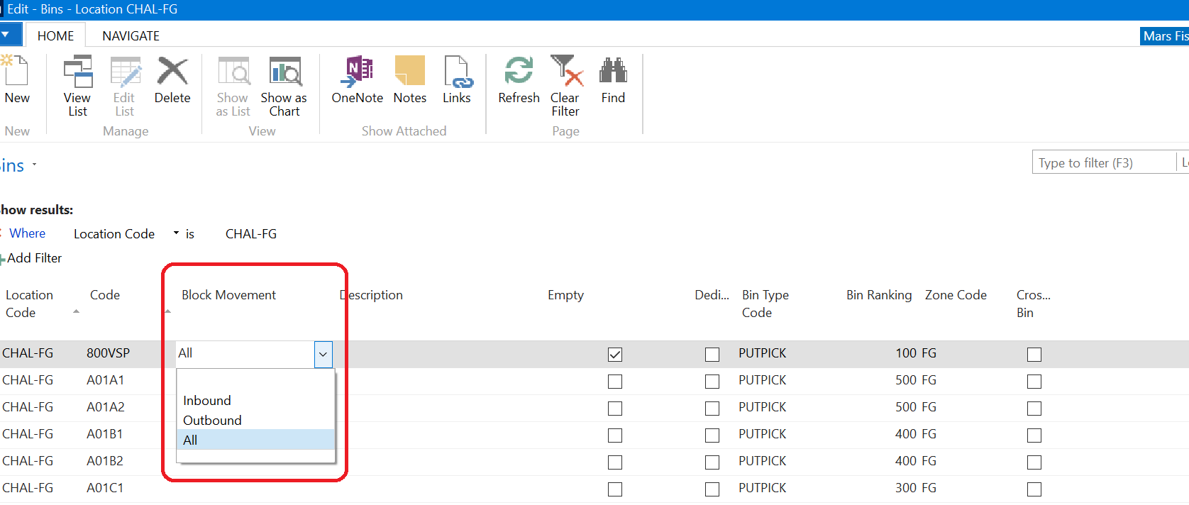

    You can block the use of bins.​  Make sure the Block Movement column is displayed and then you can block inbound, outbound, or All movement for a bin.
    Bins
