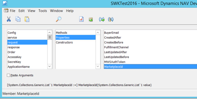

    There is a bunch of parameters that you need to set when calling the ListOrdersRequest but the one that I am stuck on is the MarkPlaceID which is required.  The thing that makes this parameter a little weird is that it is expecting a List of strings not a text variable.  So as you can see below this parameter is expected to be a Dotnet List variable (System.Collections.Generic.List'1).

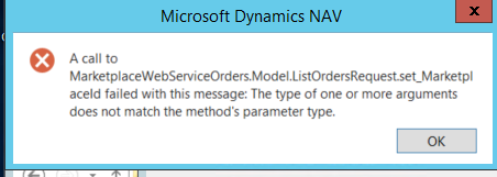

    Everything compiles as it should but I get a runtime error:
    This is just plain wrong since it does match.  Same code works fine in C# just not NAV.  Has anyone encountered this and if so what is your workaround?

    When creating your List object in NAV you do not specify the type of List (List<string> or List<int>) and that means it will create a List<object>.
    I am guessing the MarketPlaceId properties of the request is strongly-typed and will expect a List<string>.

    This article confirm what I was referring to. If you create the list in NAV it will be weakly-typed. However they used another object (x) for which the method GetAStringList returns a strongly-typed List<string> to instantiate a  List<string> in NAV.
    So I don't think in NAV you can specify the type when using the List constructor you will have to use another object that will instantiate it for you.
    You can create an interop class in Visual Studio with static methods that returns an empty List<string> then call that class to instantiate your object in NAV. It the same as the example for the Array found here https://msdn.microsoft.com/en-us/library/hh167470(v=nav.90).aspx.

    Tijane I was about to implement your solution when a colleague (Jack Reynolds, thanks!) pointed me towards a post that answers this issue all within NAV.  Here is the article:  http://vjeko.com/generics-in-net-interop-for-nav-2013/.
    So I have a function in NAV now called InstantiateStringList that creates a List as a string and solves the error I was running into.  Here it is:
