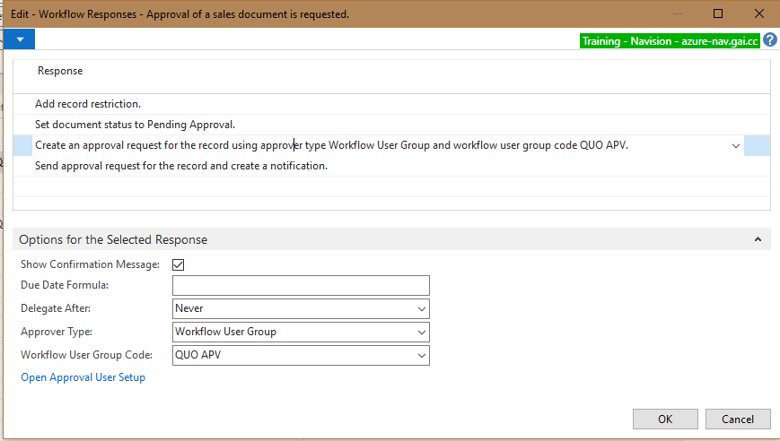

    So, WHEN: Approval of a sales document is requested, [ON condition omitted], THEN:
    1. Add record restriction
    2. Set document status to Pending Approval.
    3. Create an approval request for the record using approver type Workflow User Group and workflow user group code QUO APV.
    4. Send approval request for the record and create a notification.
    Screenshot below of the top line of the workflow;
    This screenshot shows that a Workflow User Group is setup as the Approver. It is unclear to whom the Notification should be sent.
    It is unclear to me to whom the notification will be sent from looking at the Workflow itself. I would expect the Approver Group to get the notification, however, instead a single user is getting all the notifications - and I didn't specify this user as a recipient anywhere in the setup.

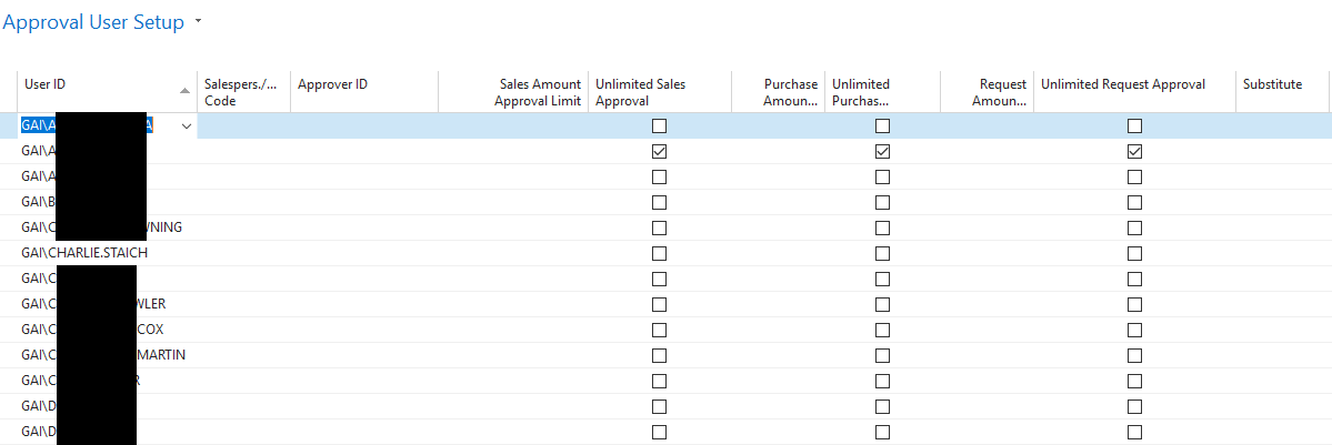

    The Job Queue Entry "NOTIFYNOW" appears to reference the Approval User Setup table to look for a recipient. This is counterintuitive to me, because I would expect that the entire Workflow User Group get the notification. Even more counterintuitive: as I have not specified an Approver ID, all notifications are being sent to the last Approval User in the list (alphabetically).
    Screenshot of the Approval User Setup table below [usernames and emails omitted from screenshot, but are all valid];
    Approver ID's are all missing, which may be causing the error, but is misleading
    What am I missing here? Does this Approver ID field need to be filled just so that it can be ignored? Does this Approver ID field store the sole recipient of all notifications regardless of who the Approval Group is?
    How do I get a Notification AND an Approval Request to go to the same group?
