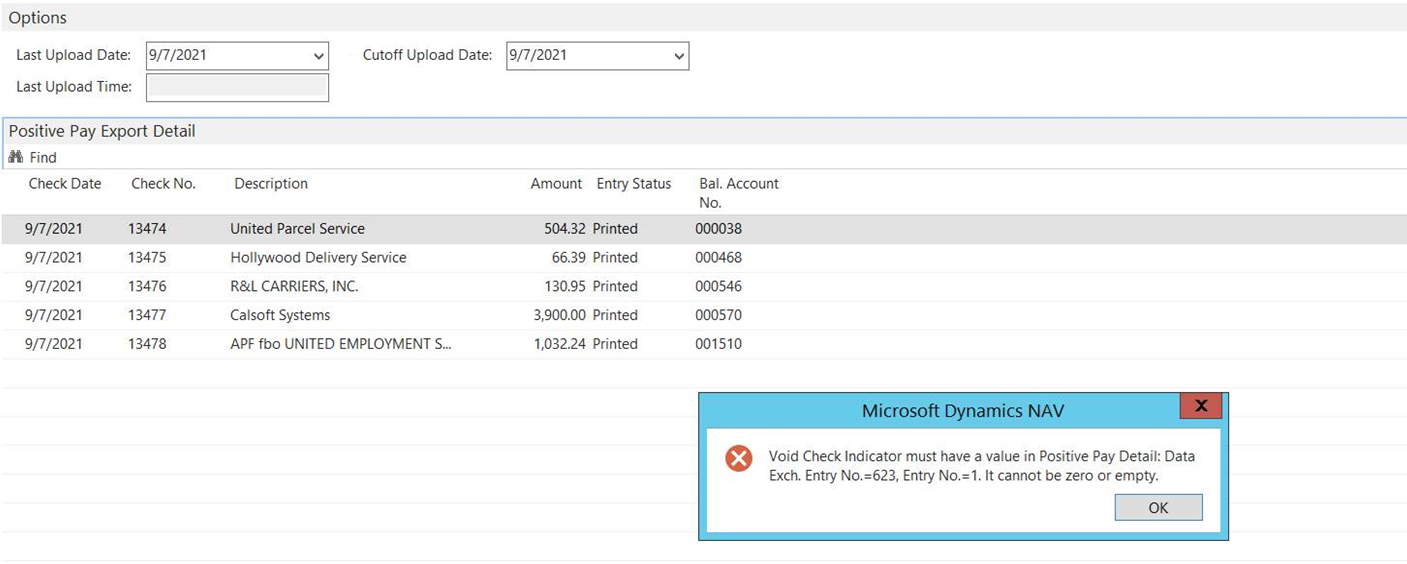

    Need some assistance on the below error receiving while executing Positive Pay Export.
    Not sure why the error pops up while running the Positive Pay Export. Any clue as what could be the reason for the above error.

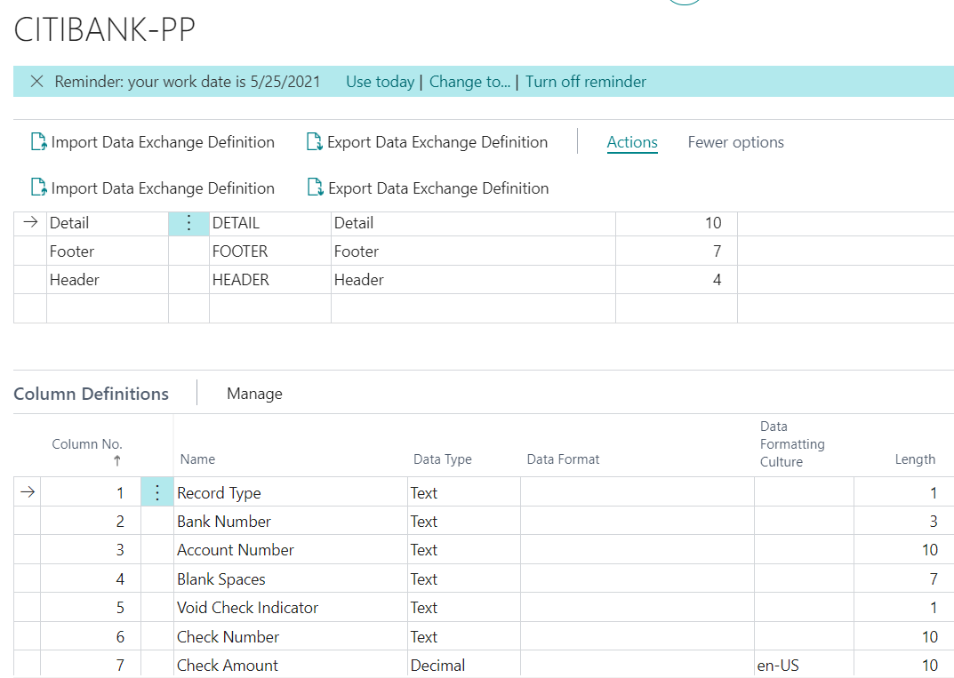

    I will explain using BC. In a Positive Pay file their is a Void Indicator value that has to be sent. You can Show the Column on the Page you copied. Here is my Data Exchange definition for a Citibank PP file:
    Hope this helps.

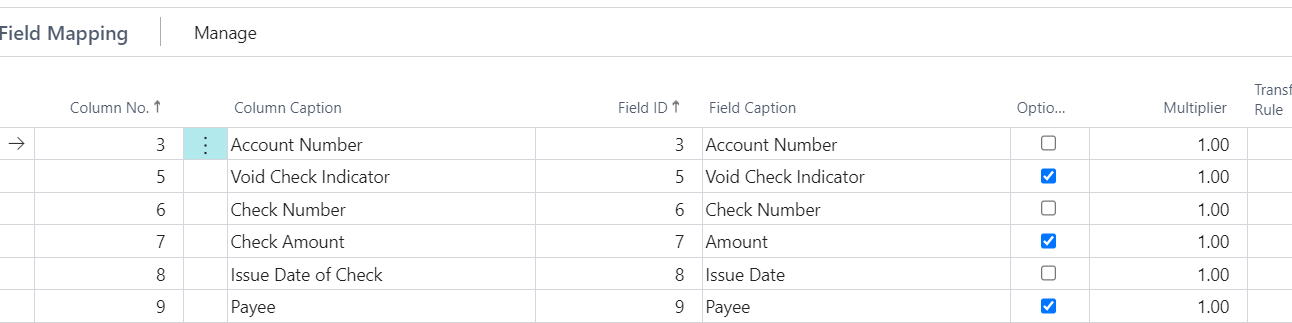

    Thank you for sharing the screenshots of Positive Pay Detail Setup under BC.
    I did compared all the screens with mine and found out that Void Check Indicator was not set as Optional.
    After I made that change on my end for Void Check Indicator Field to set it as Optional, the error was gone.
    Thanks once again for your help.
