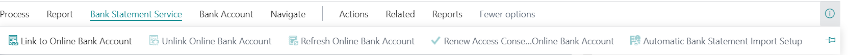

    2. On the Bank Account Card, click Bank Statement Service then Link to Online Bank Account.

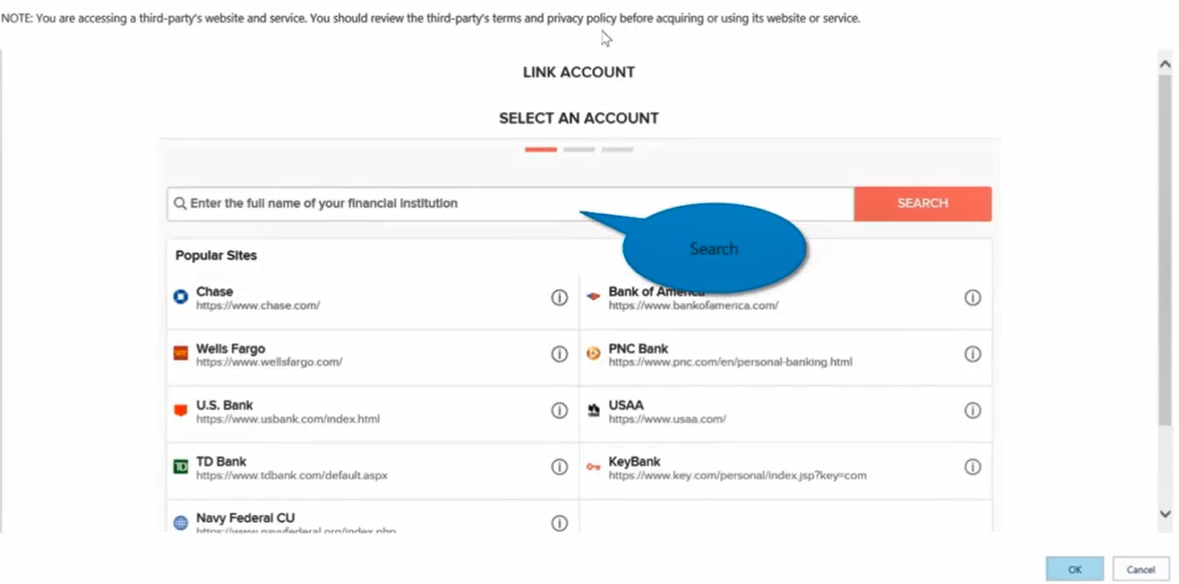

    3. YODLEE should find your Bank of you have 'named' the Bank correctly but if not you can search for it

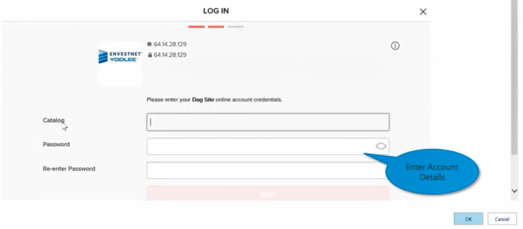

    4. After you click OK on your Bank selection you will be prompted to enter Log In credentials (something like below). Note that each Bank is different and could require Login ID, Password, and possible TOKEN No.

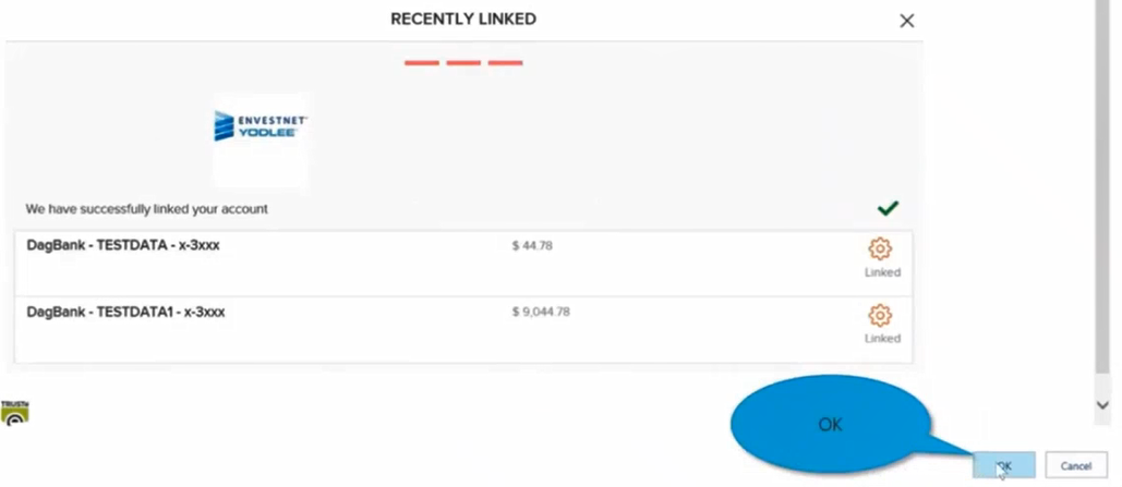

    5. After you connect you will see a list of possible Bank Account Numbers to link too. Select the one you want to link to the Bank Account No. in BC and click OK

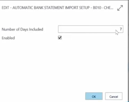

    That is it. You can establish and Automatic Bank Import by going back to the Bank Account Card, for the Bank you just linked, and under Bank Account Service, click Automatic Bank Statement Import Setup (see step 1 image). On the screen you set the numbers of days the import will include (these are the number of days between imports so if you are doing weekly 7 would be the value). Check the Enabled box and click OK.

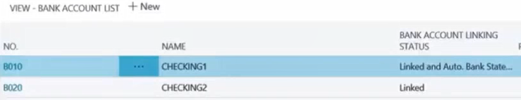

    Your Bank is now Linked and Auto. Bank Statement Enabled.
