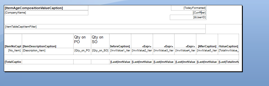

    this is what the layout currently looks like.

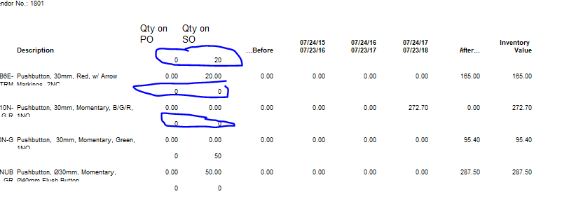

    I have added the Qty on PO and Qty on SO columns.  Here is how the report looks when I run it
    Where is this extra line of data coming from?
    If someone can help me to remove that line I would greatly appreciate it.

    seems that each line is printed twice, once with the new values and all other values empty, second with all values. first check the loaded data (with ctrl+shift+f1 in preview), compare them with the line values in the correspoding table/page (if possible). additional check if there is a visibility condition on the tablix line, also check the used dataitem and triggers, if there is a code which loads each line twice, but with different values.
