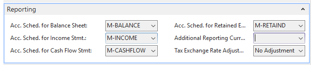

    On the Reporting FastTab on the General Ledger Setup screen in NAV 2018, you can select which Account Schedule to use for your default balance sheet, income statement, etc.  You can select your custom Account Schedule or stay with the "M-" built-in Schedule.  There should be a warning displayed because:  If you "Generate Account Schedules," NAV will replace/update whatever Schedule that is shown in the GL Setup with NAV's "M-" version.
    For example, if you adjust your balance sheet G/L Account Categories and then select "Generate Account Schedules" with the intention of updating the M-BALANCE Account Schedule, all Account Schedules named in the GL Setup's Reporting tab will be changed to conform to the built-in versions.  If you had created a custom income statement Account Schedule and selected it in GL Setup as your Income Statement, it would be lost.
