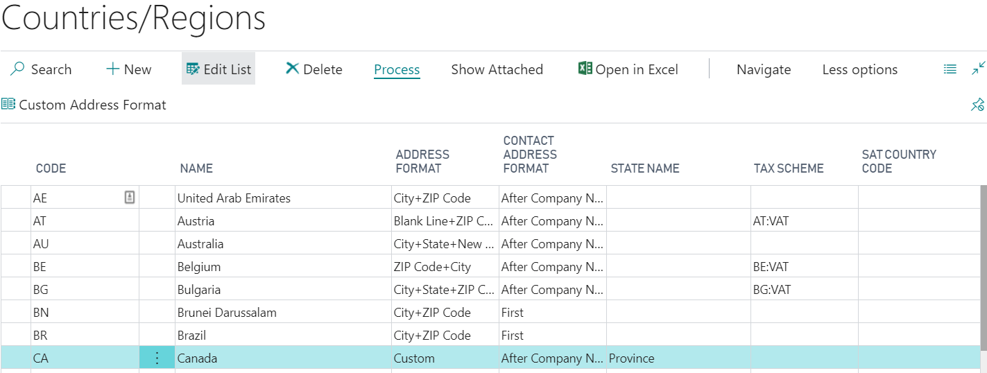

    Go to General Ledger Setup. You will see the field Local Address Format. The drop down give you several choices to select from. Since you want Province + City + Post Code you should select Custom. Then go to the Countries page, find Canada (CA) and edit the list. In the Address Format choose Custom and then Process/Custom Address Format. Then build your own.

    One strange thing I noticed i.e. in my setup I don't see state option in any of the address format list. How to fix this?

    City + County + Post Code is the choice. County = State.
