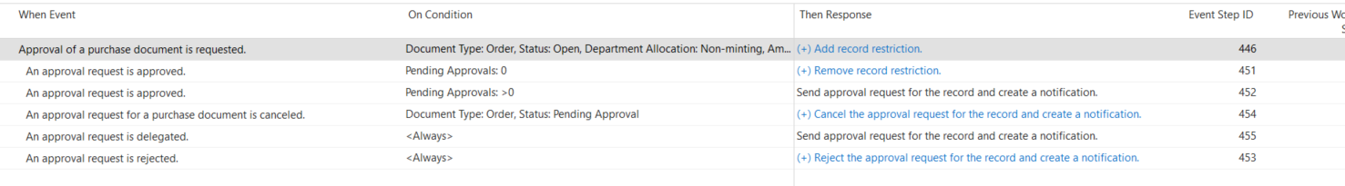

    Hi All,
    [NAV Version: 2018]
    I have created a new workflow for Purchase Order from the template.
    There are 2 approvers need to approve a PO. Even after the final approver approves, the Status is not getting changed to RELEASED and still showing as PENDING APPROVAL.
    When I checked in Restricted Records table, it is showing as:
    Purchase Header: Order,PO002607, The restriction was imposed by the MS-POAPW-2A workflow, PO Approval for Depts.(015,019,026,027).
    Once after deleting this line in Restricted Records, then I can change the status manually.
    Can anyone let me know what am I missing?

    Hi All,
    I freshly created the workflow from scratch as I did not find any flaw before in the old workflow. Now this issue got disappeared and working fine.
