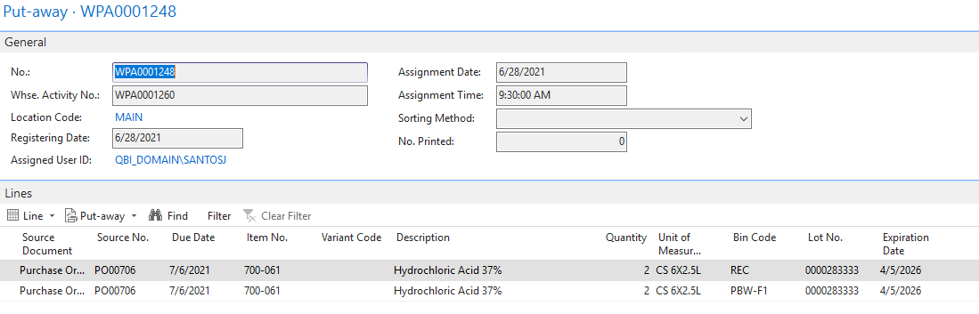

    Hi Steve- thank you so much for replying- I always get confused about the warehousing terminology- we are not using directed pick and put away- (is that advanced warehousing? ) I have attached an example of our putaway doc below. We do for sure use warehouse receipt for receiving-
    Can you explain when we would need to run Item Journal/Calculate Warehouse Adjustments? Every time we do consumption? At the end of each day? Or every time we post an item journal? Thanks for the help I really appreciate it
