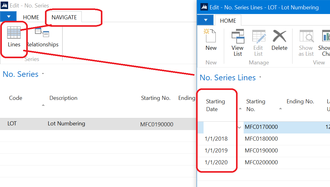

    If your problem is with the number series, check the ​Starting Date in the Number Series Lines:
    No. Series Lines

    Thanks for the clarification. I checked the No. Series we have the correct Starting Date for the 2019 No. Series.
