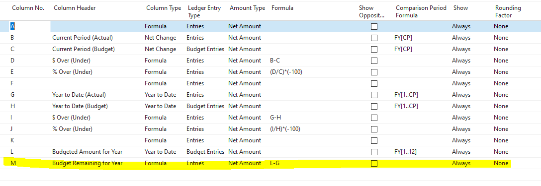

    I am creating an account schedule in NAV 2017 to show Budget to Actual for the current period, then YTD, then I want to see the budgeted amount for the year and the amount of budget remaining.  For some reason, everything is working except for the last column does not show when I run the overview.  I've search and cannot seem to find an answer.  Does anyone see a problem with my setup which might be causing the column not to display?
    Here's my column layout:

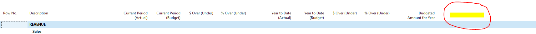

    Here's what I am seeing when I run the overview:

    Try setting column F or K to "Show" to Never. I think you may have hit a limit at 12 columns.

    If you are reviewing this in the overview and are just missing the last column, the suggestion from Andrew will work to display.  However, you can also get to any additional columns over the 12 limit by using the "Next Column" button in the top ribbon of the overview to advance the view to those columns.

    I did not realize there was a column limit, which there really isn't, you just have to use the "Next Column" selection if you have more columns than 12 on the first "page" of the overview.  The limit is on the number of columns which show on the overview screen, not the account schedule per se.
