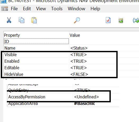

  • 6.  RE: FastTab available fields
    Posted Dec 17, 2020 02:16 PM
    I'm not sure what you mean by going to the control on the Page, but if I'm doing this right, in the Development Environment I go into Design of the Employee Card page. Click Position Code, View, Properties.  AccessbyPermission there is also <Undefined>.
    Yvonne Jury
    Business Systems Analyst
    Scheid Family Wines
    Salinas CA
    Digital Acceleration Binge Day.  January 28th 2021 | 11:00 AM - 2:00 PM EST
  • 7.  RE: FastTab available fields
    Posted Dec 17, 2020 06:00 PM
    Check all of these properties on the table and page:   Visible, Enabled, Editable, Hide Value
    Do they all have a TRUE or FALSE value or do any have another value (a variable name).
    They should all be TRUE except for HIDE VALUE
