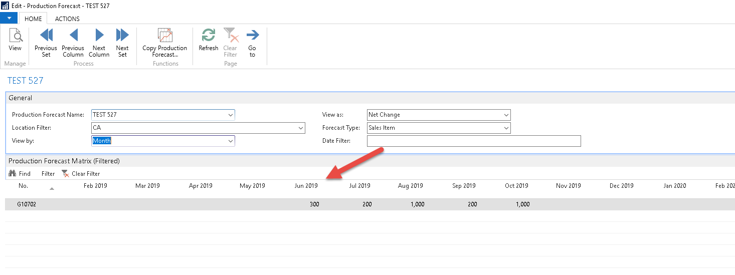

    We are working with the planning worksheet and forecasting to create purchase orders.  I am having an issue with getting the suggested expected receipt date to reflect our requirements.  We want to  buffer the expected receipt date by 60 days.
    Our forecast is based on previous years sales.  Ie:  Sales from June 2018 are used to plan for requirements in June 2019.
    Forecast

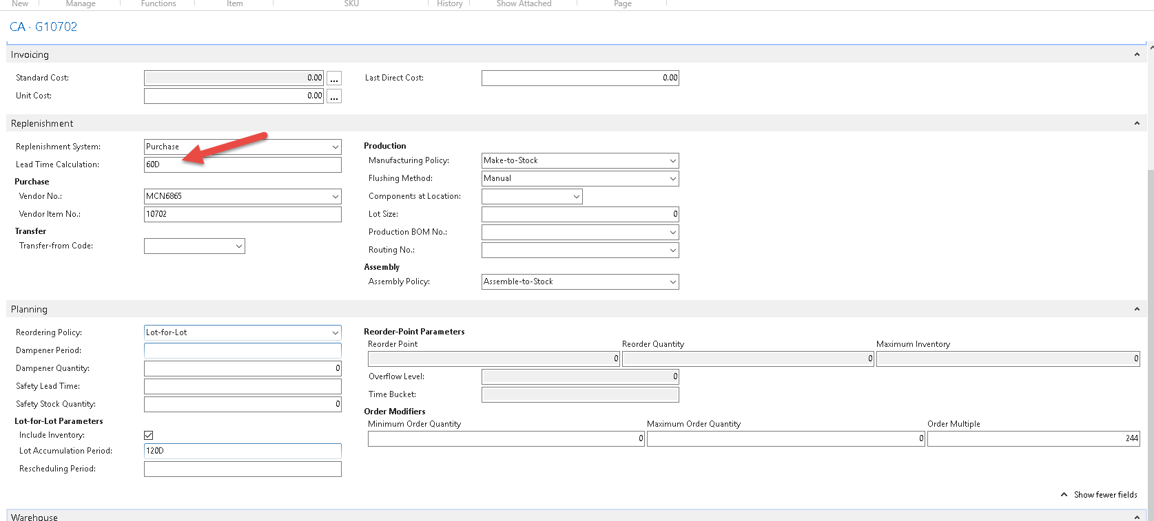

    This item has a 60 day lead time from the vendor.  We use a lot accumulation period of 120 Days ( 4 Months )
    .Item setup
    When we calculate the plan, all of these settings work perfectly.

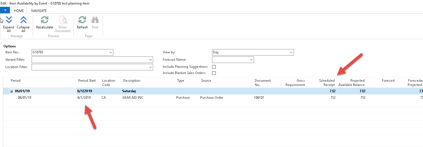

    However, we need to product to be arrive, 60 days prior this.  In this example we want to buffer the due date (expected receipt date on the PO)  by 60 days -  Due date April 2, 2019.  The only date I was able to affect was the planned receipt date by entering 60 days in the safety lead time field.  This affected the planned receipt date, but the date that is used by the system as the scheduled receipt date is the expected receipt date and not the planned receipt date.
    Item availability

    However, Nav is still looking at the expected receipt date.  If I enter demand for May, Nav is telling me that we won't have stock, even though our planned receipt date is prior.  Is there any way to get Nav to evaluate the planned receipt date rather than the expected?
    item avail
