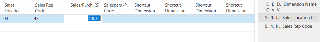

    Under purchase journal, after selecting document type, account type, amount and etc, all is well upto here but when it comes to Sales Rep (shortcut Dim 1) and Sales Loc (shortcut dim 3), when i select sales rep as value 43, the system auto picks up sales loc with value as 04 after go to a new line and come back to the original line. see the screenshot

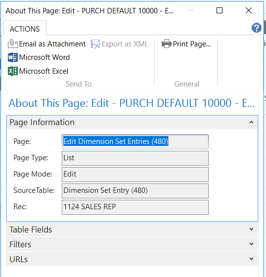

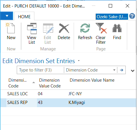

    When I click on Dimensions from Navigate Group,
    It shows me the sales loc is having dimen code value as 04, but also i want to have new value 02 under sales loc, so when i click on help; about this page
    It tells me that Dimension Set Entry Table (480), I must search for record number no. 1124.

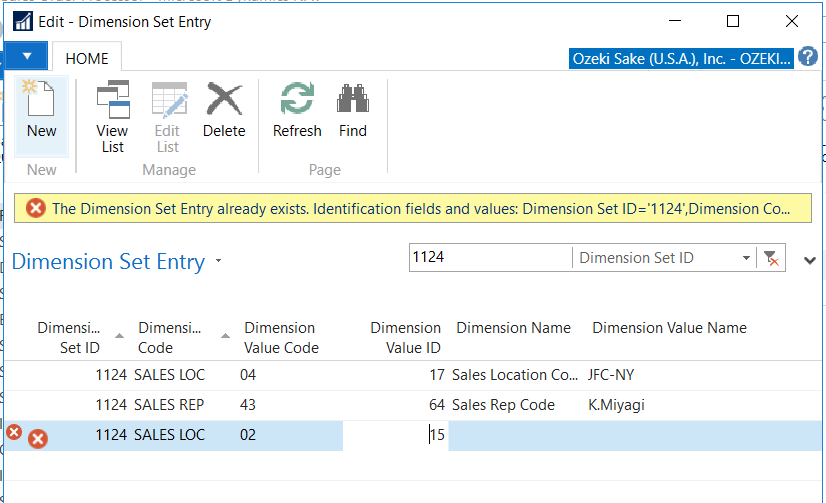

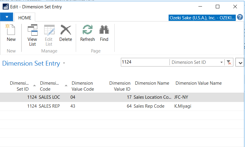

    So after opening up Development Environment, when i run table 480, filter on Dimen Set ID as 1124, shows me this result below
    Here in the above screen I want to add a new value for Dim Code "Sales Loc", so l enter a new line as below
    But it gives me error message as Dim Set Entry already Exists.
    So the question is how to add a new value in Sales Loc where it can show me 04 and 02 simultaneously.
