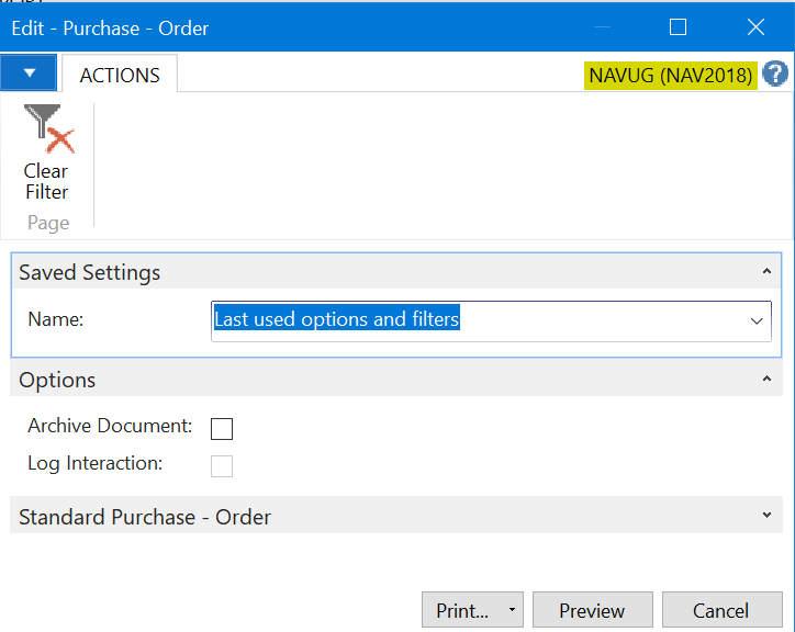

  • 12.  RE: Purchase order archive mistake
    Posted Feb 17, 2019 07:36 PM
    ​A Purchase Order can become archived through the print function (there'a an Archive Document check box on the optopn tab), but that will not delete the uninvoiced purchase order.
