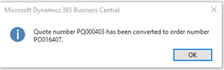

     But when I convert in order, happen the below:
     Purchase Quote delete and create a Purchase Order
    The quote disappears and with this the tracking of the dates too.

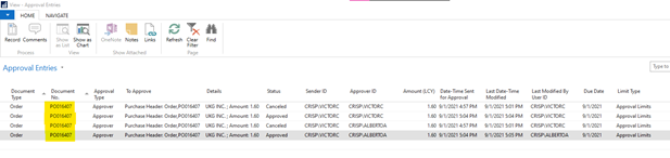

     But in the purchase order, the record in the approval entries was "changed".
     And when the purchase order is posted, all the information in approval entries is deleted.
