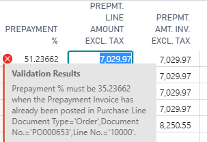

    Thank you so much for your response. When I try to edit the Prepayment % or Premt. Line Amount Excl. Tax (I don't have the option to add Prepmt. Line Amount Excl. VAT to my view) I get the following error:
    Prepayment Error after a Prepayment Invoice has been posted
    I have tried using designer on the web client and customize in the rich client to see if I can add Prepmt. Line Amount Excl. VAT but I am unable to find that field at all.
    Do you know why this might be happening? We are on BC13, I forgot to mention that in my initial post.

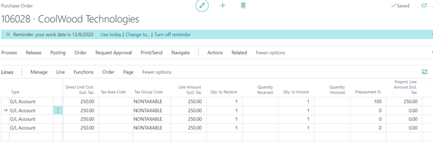

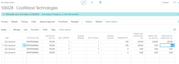

    In the meantime, I did, in BC 17.2 test the following and it did work:
    1. Created a PO with a Prepayment Purchase Line record and amount. I then entered the 1st Prepayment amount in the % or Amount column as 100% of the amount and Posted the Prepayment
    2. Below you see the Prepayment of 250 under the Prepmt. Amt. Inv. Excl Tax column.
    3. Below I repeated a prepayment for the 2nd Purchase Line and posted the prepayment. I repeated this a 3rd time and on then when the Items Received Post Receive and then final Invoice arrived Post Invoice.
    My apology again for answering the original discussion with something that was unknowingly modified. The above is not very streamlined but does accomplish the multiple prepayments against a single PO. Hopefully we will see the correct way in a future release.
