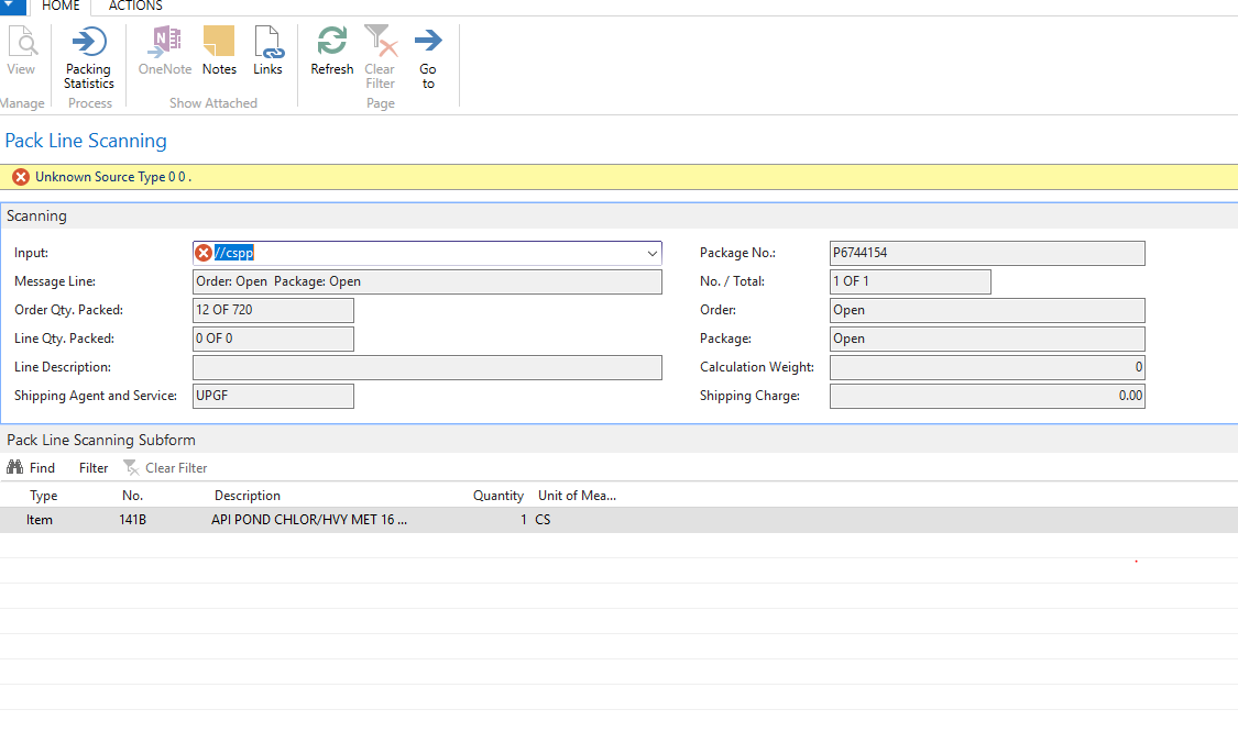

    Our process is to generally enter the sales order and then //CSPP.  In this case, it looks like the order was alreayd partially packed and they were trying to pack the rest of the order (not sure), since the screen shot said 12 of 720 were already packed.
    Earlier in the day we had other errors for this customer because there was not Shipping Agent Service assigned to the Shipping Agent assigned to this customer.  We made assigned a service while some orders were in process and I belve that this error (below) was somehow related to that situation.
    Like I said, we've moved on, so this is no longer an open issue and we're not concerned since it appears to have been a one time event that we were able to work around.
    Thanks for jumping on the thread.
    Pack Line Error
