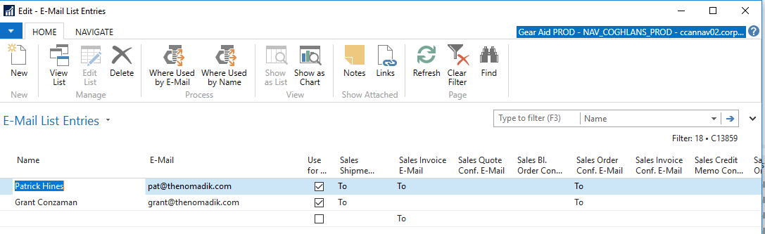

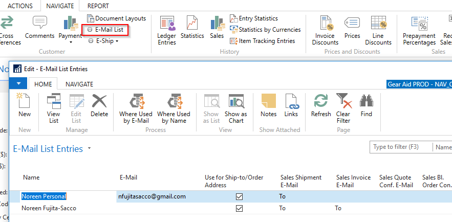

    If you're using Lanham E-Ship, you can use E-Mail List Entries.
    Entries
    Hello, All.
    We're on 2018 NAV using Lanham E-Ship/E-Mail. There is functionality with E-Mail List Entries that allows storing multiple names/addresses and assigning them to specific documents.
    E-Mail List

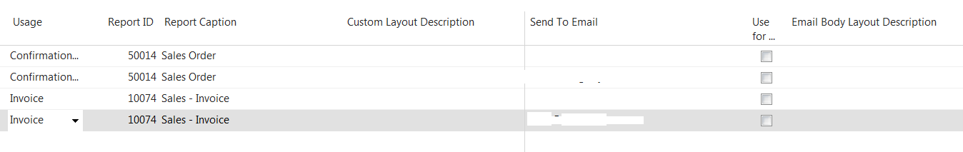

    We have E-SHIP but don't see the E-Mail List entries.  I think there is another piece beyond E-SHIP for that.  However, we use the Document Layouts
    The only caveat is that we found performance issues - pretty sever, if we used a Custom Layout, but the email field does allow multiple email addresses by use of the semi-colon, and if you want to send seperate emails, you just add a second line.
    These can be set up from the customer or vendor cards (Under Navigate)  Look for Document Layouts.
    There is a little setup that is needed.

    We have used the document layouts on the customer and you are still able use the semicolons and multiple addresses there. We are still using this in BC.

    Chuck, thanks for the tip, that is a good one.  I think that might meet our needs without having to do a mod!
