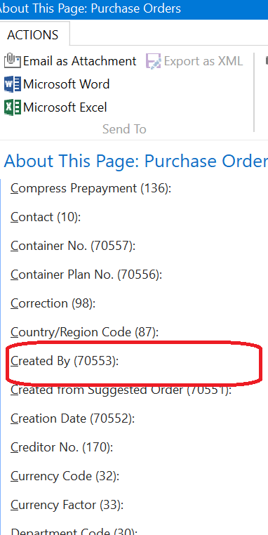

    Hello Ronald,
    We're on NAV2013R2 and I see a field called Created By that contaiins the USER ID for the person who entered the purchase order:
    The fiels is in Table 38 - Purchase Header, but is not on the page.
     ​​PO Header

    Lewis,
    that field in not on our Purchase Order (Header or Table 38) for NAV 2015.
    I also went in to the Designer and nope no Created By field for the Purchase Table.  Must have been take out for NAV 2015.  Interesting

    I don't see the field in my NAV 2018 playground either.  In our production system there are a few fields all in the 70000 number range that are related to manufacturing, so I guess they are either only there for manufacturing or they may be part of Lanhams's DP add-on.​
  • 5.  RE: Who Did it -- Created a Purchase Order
    Posted May 13, 2019 12:29 PM
    Yep, you'll see that's a 70XXX field, and since it is between 50,000 and 99,999 it is a custom field.
    If you want to see who is creating and updating records, just turn on the change log for that table: https://www.archerpoint.com/blog/Posts/change-logs-and-microsoft-dynamics-nav-2016
    It won't be a field on the header / lines that you can see or filter on, but you can drill into the update history.
