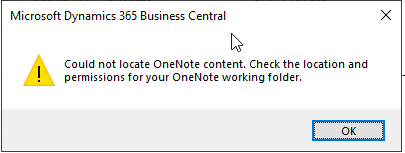

    Hello,
    Some of the users are getting below error
    path is valid and users have full permissions to the network folder. Please let me know what else should we check?
    thank you!
    Alicja

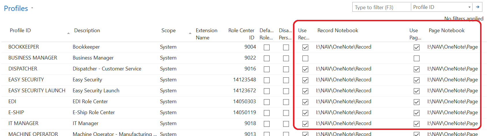

    Check to make sure that those users belong to a Profile (Administration/Application Setup/Role Tailored Client/Profiles) that has the OneNote path assigned.  In my example below, anyone with a User Personalization set to "BUSINESS MANAGER" would not have access to the OneNote data.

    Hi Lewis!
    Thank you for the reply!
    I have it setup on the profiles assigned to the users, however, I don't have separate folder for 'Record' and 'Page', could that be an issue?
    It all links to ...\NAV\OneNote folder
    thank you!!
    Alicja

    I don't think that will be an issue - at least not a permissions issue.
