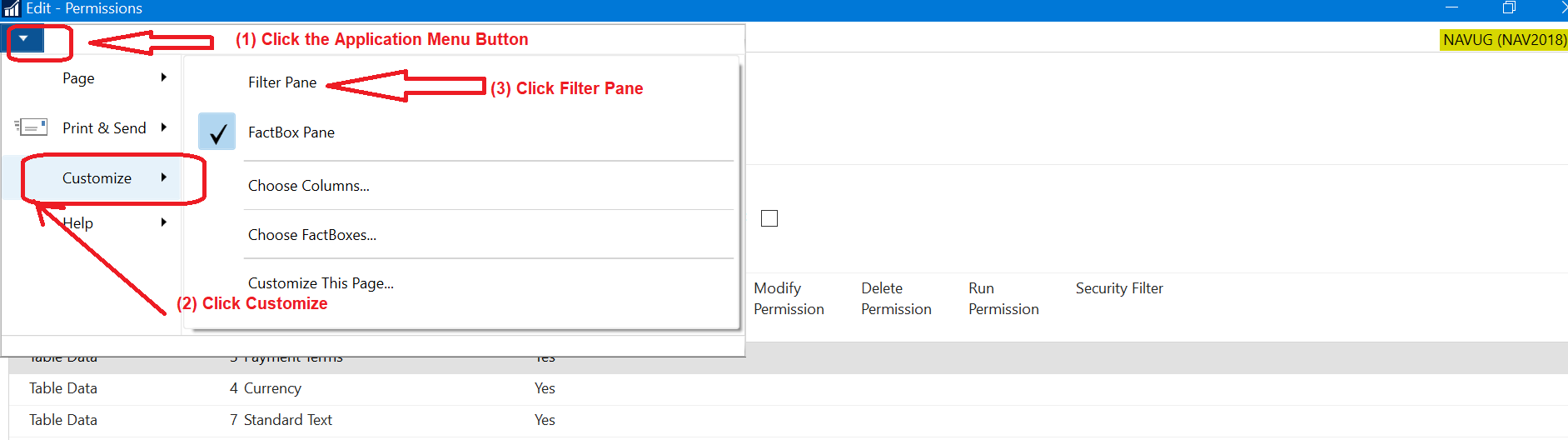

    ​You just need to turn on the filter pane.
    Turn on Filters

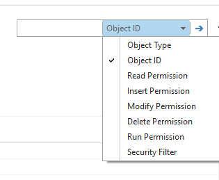

    Thank you for the great tip.  The Object Name (table description) is still not in my drop down and I cannot search for it.  Is it that way for you to?

    The filter drop down (right side) will only show the columns you have displayed.  If you are not showing the Object Name on the Page it will not be in that filter drop down.  Use "Choose Columns" to show the Object Name field, which would add it to the filter drop down.
    You should still be able to use the Advanced Filter (left side), which allows you to filter on any field in the table regardless of whether it is displayed on the Page.

    Hi Ben,
    Thank you.   I am displaying the Object Name in my page.  I still don't see if in my drop down menu.  I just had my developer look at this field and it is a function.  I am able to get to that field through the Advanced Filter, go to All and see in the list.
    Thank you. This is a good workaround.
