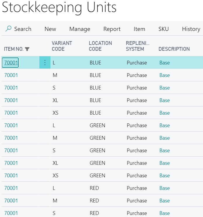

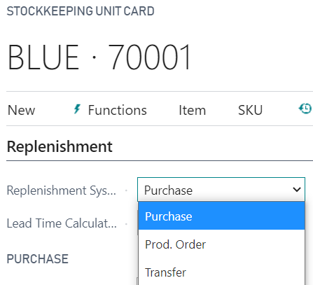

    You noted that you want to define the Size to designate the Transfer or Prod. Order. How are you doing Size today or is this the new request? So you Stockkeeping Unit Card looks like this:
    You select the one you want per Location, yes? You would need to setup the Sizes as Variants to meet the requirement so the screen list will look like this:
    I can update the Replenishment to Transfer on the ones I need and Prod. Order on others. Now I have an Item, by Size, by Location defined for Replenishment.
