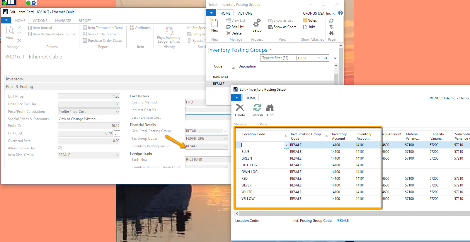

    The Inventory Posting Setup can be found by drilling down through the Inventory Posting Group on the item card.  The Inventory Posting Group on the Item and the Location on the transaction determine the Inventory Account. Is this the account you are looking for? #Functional
    Inv Posting Setup​​

    Hi Cynthia,
    Yes, that was exactly what I was looking for!  Thank you so much for your help!
