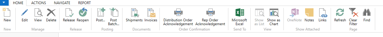

    We have found when we went back to review those sales orders the Fact Box Notes are being dropped.
    The notes can also be added from an ICON in the Ribbon at the top of a sales order  view.
    Has anyone else experienced that situation?
    Thank you in advance
    ribbon display of note icon
