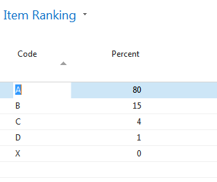

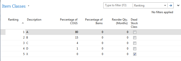

    These fields are part of Lanham's AFP module, which I assume is what you are using for your ordering screens.  Searching "Item Class" and "Item Rank" in NAV should bring these tables up which will explain how the rankings are assigned.
    The ranks are assigned to every Procurement Unit, and you can report on them that way.  The ranks update at the end of every month, and you can look at past records for each Procurement Unit in the Item Usage page.  In general, we evaluate items & inventory based on other metrics, but the Classes/Ranks provide a very quick way to judge if something is valuable or not.
    Item Classes rank items by the value of COGS.
    Item Ranks ranks items by the frequency of hits (sales lines).
