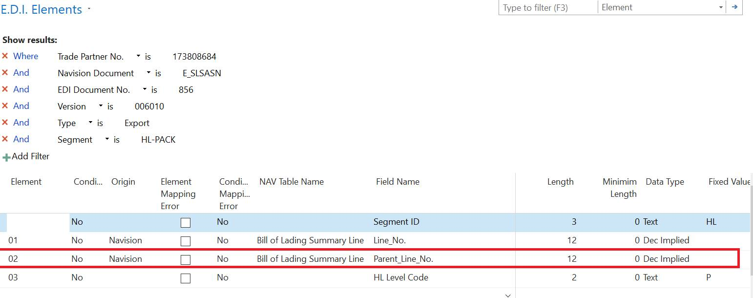

    The HL-PACK segment map looks like this:
    EDI map HL-PACK
    In the data, for the HL-Pack segment, the HL-02 (parent line number) sometimes changes from a value or 3 to 2.

    Hello Lewis,
    I am pretty sure those packages with HL*2*P~ were not added to the tare pack. The '2' in the HL-02 represents the ORDER level.
    What you can do is go to this Bill of Lading and in the ribbon select Navigate >> ASN Summary.  If the "Line No" and "Parent Line No" are shown, this is where the map is getting it's values from.  Find the erroneous package where the Line No. = 2536. Double-click on the Description of "Package xxx" to open the package page.  While on the header of the package, Zoom (Ctrl+Alt+F1) and expand the 'Table Fields' fast tab.  Scroll down to "Used on Bill of Lading No."  I am assuming this value is blank.  The "Used on BOL" field is populated with the tare package of which the carton package is placed within.  If this package was not placed in a tare-pack, then it is viewed as a standalone package thereby it's parent would be the ORDER level.  I hope this makes sense and clarifies the issue.
    In the future, if the goal is to have all carton-packs placed within a tare-pack, then during the time packing using Pack Line Scanning you may want to run the //ASP (Add Select Packages) command.  This will display a screen where the "Package Line Type" is either Item or Package (see attached screen shot).  Those with  "Package Line Type" = Item are E-Ship packages that contain package line type = Item (carton packs). Those with  "Package Line Type" = Package are E-Ship packages that contain package line type = Package (tare packs).  So the goal would be to not have any where Package Line Type = Item because they would have been left off a tare.I hope this helps you out!

    ​Thanks Charlotte.  You are always so helpful and I REALLY apprceiate it!  Our partner worked with me today and I discussed it with our Shpping team.  Our theory is that the order was partially picked and packed and a tare/pallet label was created (//AAP).  Before the order was completed, more inventory became available for the order and our shipping team manually added packages (to the order; not to the TARE) from the Sales Header - Navigate > eShip > Packages.
    I hope to take a deeper look at this tomorrow to see if I can reproduce what happened and determine the best way to avoid it from happenig.  I don't think anyone is familiar with //ASP, so I will definitely check that out too.
