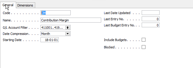

    ​Our Accounting is trying to update the Analysis by Dimension but getting an error saying the Analysis View Entry does not exist.
    This is the message we are getting when update

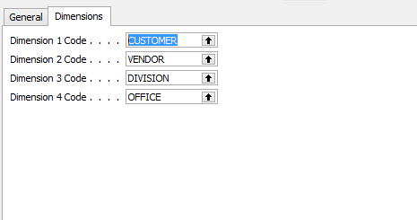

    This is the setup of the Analysis View Card
    What is causing this to happen?
    We have reset the view and try to do the update but still getting thesame message but different information.

  • 2.  RE: Analysis By Dimension -Getting The Analysis View Entry does not exist
    Posted 12-06-2018 05:55 PM
    Edited by David Yee 12-06-2018 05:59 PM
    To me, it looks like someone deleted the data.  I would check the last update date.  I'm pretty sure when I deleted the data the last update date changed.  We use an ancient version of Nav but so it might be different for later versions but I think you only do this in the dev version.
    When performing the update, I'd strongly recommend having your microsoft partner do the update.  I did the update and for some reason it got hung up and locked the system.  We had to revert the database to the last update and lost a day of production.  I don't think payroll has forgiven me to this day and earned me the nickname crash.

    I may suggest going to some of the transactions to confirm Dimensions actual exist for those transactions.
    Next try going to the Chart of accounts to see if the dimensions exist in various top menu choices:
    G/L Balance by Dimension
    Report Trial Balance per Global Dim.,
    Report Trial Balance Spread G. Dim
    I don't know what version you are running or is this from an upgrade which now they switch over to Dimension Set ID, that might not be transferred correctly.

    Do you require monthly compression of data? ​I would suggest running it without compression, and starting on 11/1/18. If that work then try daily, weekly, then monthly compression. This will allow you to narrow down the source of the error. If you don't need monthly compression, you may have a working Analysis View.

    ​We reset everything and redo all the analysis by dimension - this seems to work.
    We are not doing it by compression.
