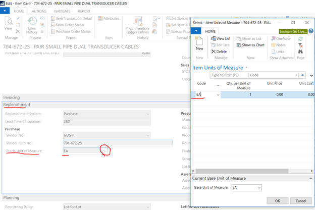

    Hello John,
    We had a similar issue a couples months ago when we added items in through rapid start.  We received the same planning worksheet error.  However, when we checked the item card we were confused as it looked like the unit of measure and purchase unit of measure were setup correctly.
    However, after clicking the dropdown on purchase unit of measure on the item card we saw the "Code" field was blank.  Even though the EA code displayed on the item card itself.  We just added EA and clicked ok.  We had no issues with those parts after we added the "Code" field.
    If you have a lot of these items you may want to see if you can use a rapid start and add both unit of measurement fields.
