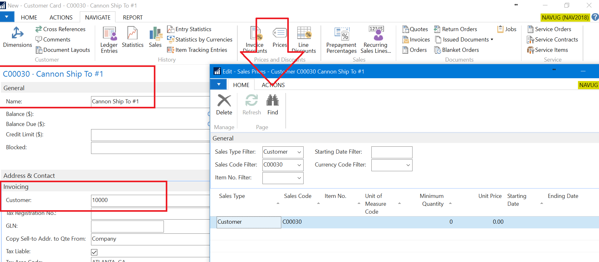

    We have a customer with, multiple ship to addresses, that we need to allocate discounted pricing according to their specific "ship to addresses".  Does anyone have any ideas on how to do that, besides creating special item numbers for the discounted pricing?
    We are using NAV 2013 RTC.

    ​I think instead of setting up different ship-to addresses, you might be able to create different sell-to customer cards for each ship-to, set up the pricing/discounting for each, and make sure each sell-to has a bill-to customer set on the Invoice tab of the customer card.
    You should try this first in a test environment to make sure you are getting your desired results.  This may also affect some sales reports that will report by sell-to and not bill-to.

    I agree with Lewis that you would need to add separate customers for each ship-to address so you can setup different sales prices for each of these and if those customers you like to bill-to one customer than specify bill-to Customer. This way your ledger entries are still combined in one place to the Bill-to customer

    The suggested way is the only Standard NAV way that I can think of. Otherwise it'd be a mod, and I don't think it's worth it.
    I go with @Lewis Rosenberg and @Naveen Jain!​​​​
